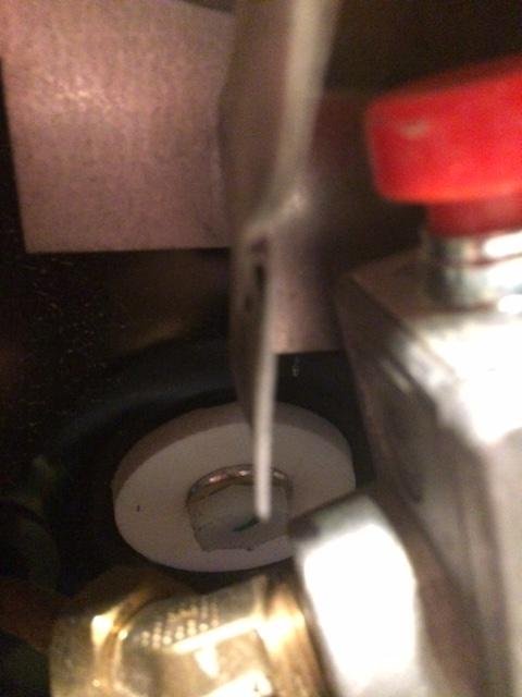

Only a suggestion... I've done this to mine and so far, it works great!
Last seen: 3 days 21 hours ago
Drain Valve
I haven’t seen one of these in use, but just looking at it does it open enough to clear all the mineral chunks that flow out when you pull the drain plug or does this just empty the water? A big part of pulling the plug and draining the heater is to wand and flush out the mineral buildup and I’m not clear looking at this if it would work to that end?
I’ve used it for two years without any problems
So far I’ve used it for two years without any problems. It’s nice not needing any special tools but only your fingers.
I’ve had very small bits come out but nothing clogged up. It works on the same principal as a radiator drain shut off valve. I guess time will tell if this is bad or not.
Obviously if mineral chunks is a big problem, this is probably not the way to go. I don't have enough experience to know if this is or not a problem. The search on the internet seems to fall in the positive range. Again (for me it works but), only time will tell...
