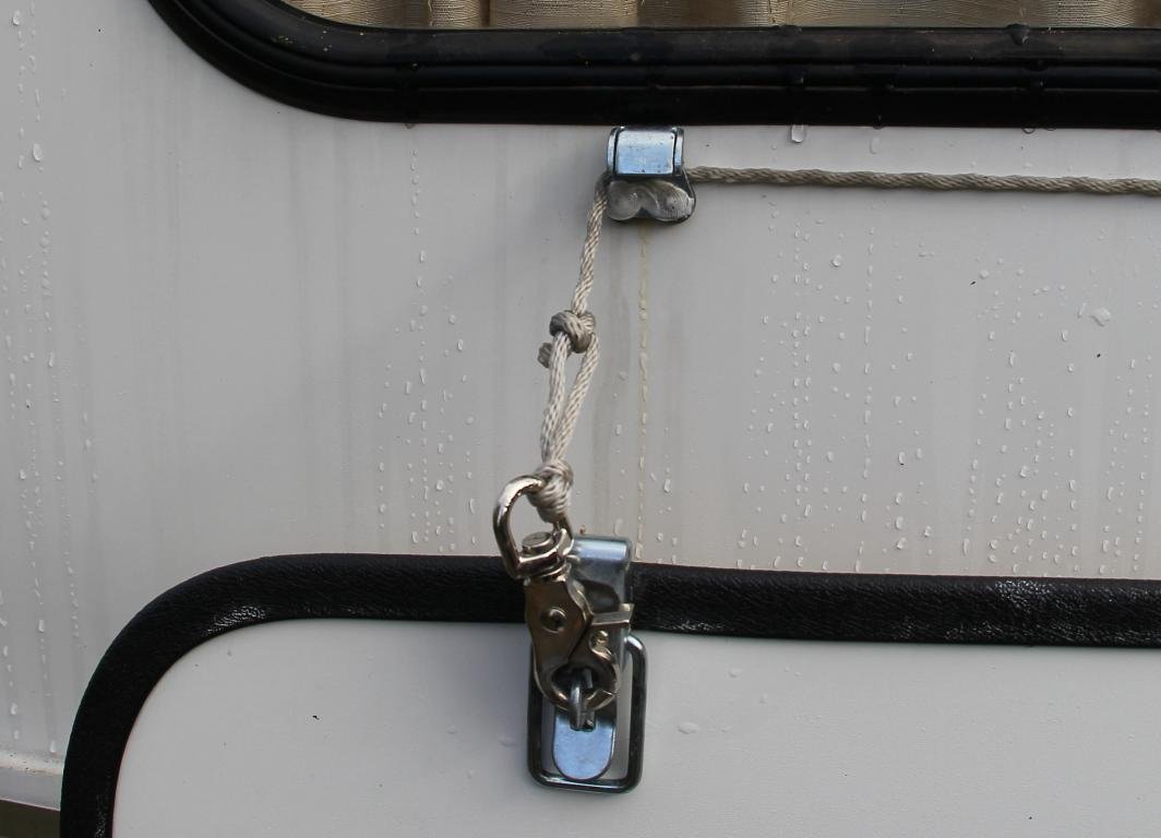

Gravel Shield As Awning
Sometimes it is nice to have an awning, (sun shield) on the front window. The attached pictures show what I have come up with to rig the gravel shield for shade. I used all stainless steel hardware and the cost was less than $15.00.

What is the function of the
What is the function of the rope that's shown across the top of the gravel shield on your "Top end" photo? Beautiful idea, by the way - I'm totally doing this.

Gravel Shield Pictures
On my original posting of my gravel shield I included three pictures Only one is there now! The missing pictures show what that rope is for. I'll try to repost the missing pictures.

One more question. How did
One more question. How did you get the eyelet screw through the eye of the swivel clip?
Last seen: 3 months 3 weeks ago
Eyebolt and Snap
Bend open the the eye of the eyebolt just enough to get the snap in then bend it closed. Clamp the eyebolt in a vise (with wood to protect the eyebolt) then pry the eyebolt open with a screwdriver. Once the snap is in place in the eyebolt put the eyebolt in the vise in a way that by tightening the vise the eyebolt will be closed.
