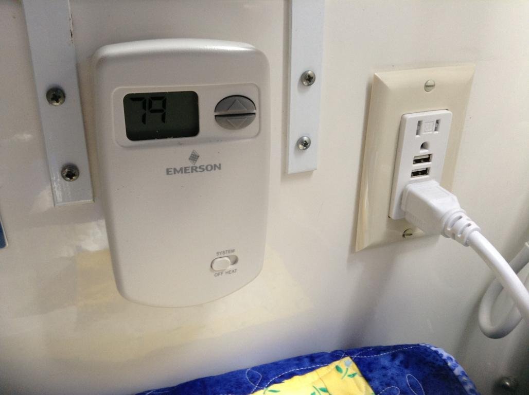

Just installed new USB outlets, extremely handy for a wide variety of charging applications. I also ordered from Scamp the new digital thermostat they are now installing in Scamps. Very easy to install.

Scamp thermostat on/off range adjustment
I am the new owner of a '09 16' Scamp. My wife and I had our first outing this past weekend. The design feature that was most troubling for me was the thermostat control of the furnace. The outdoor temp got down to 32°, so the furnace was cycling on and off. The thermostat seemed to have a very wide on/off range, i.e., it would turn on when it was pretty cold, and not turn off until it was uncomfortably warm. That bothered my sleep. My first thought was to see if the thermostat had a way to adjust (narrow) the on/off range. Do you know anything about that?
However, your post suggests that I might just replace the thermostat. You chose the one used by Scamp. How has it worked out for you? How wide is the on/off range? Thanks for your thoughts.

Thermostat range
According to this source, it looks like the range of the newer digital thermostat is 45 - 90 degrees, but if you turn it off it shouldn't cycle on though you may need a warm sleeping bag if the temps go down to freezing.
Last seen: 5 years 7 months ago
Get the new digital
Get the new digital thermostat from Scamp, works great!;

12v USB outlet installation?
ManWithaVan, how did you achieve that, adding a USB outlet into the 12V system? How did you run the wiring, etc? Do tell! Maybe start a new thread, and upload some photos? My devices are getting older now, and need charging more often than they used to. If I could charge them off the 12V, I'd practically never need to pay for electric, or run cords to kindly friends' homes. What do you suggest?
Meanwhile, thanks, Flyboy Scamp, for the idea on swapping out the standard plug for one with USB outlets. I have an adapter, but it's way clunky compared to a having an elegantly designed outlet.
How are you liking that new thermostat? I used mine a lot last week: still gets cold before it kicks in, and too hot before it shuts off; but then I think, "I'm camping. This is not my living room. I'm just happy not to be freezing." Still, if it could be better, or if there's any way to calibrate it, I'd be happy to hear about it.
