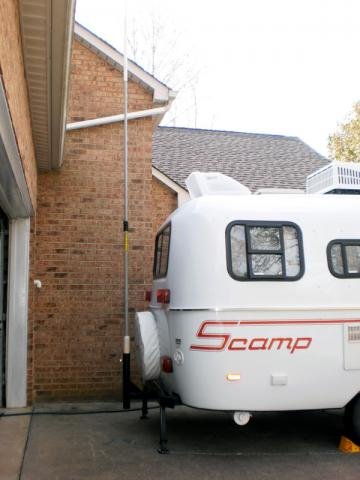

So with the planned solar panel, here is the mast for my planned TV antenna (and 20 M dipole), which wil be higher than your TV antenna ;)

Is your antenna(s) mounted to the rear trailer hitch?

Well... it will be.. but right now it is a work in progress.
I got the Hitch Mount Flagpole Holder which works well as a base for an antenna mast except that at 2 inches diameter,  it is a little wide for my current set up. In the photo you can see a fiber glass mast. It is actually a two part fiberglass pole that was a tree pruner similar to this one that I picked up at a surplus store. I used a piece of PVC pipe as an insert in the hitch mount to reduce the looseness of the small mast in the large diameter mast holder. With the height of the hitch receiver, it goes up to about 15 feet from the ground. I added a PVC pipe on the top end for another six feet and it seems very stable before adding an antenna. Maybe someday I will invest in a "proper" collapsible fiberglass antenna mast.
This is meant for a ham radio antenna, but I also want to put a HDTV antenna on it at times.  I am leaning toward the King Jack which is a directional antenna.  I could rotate the antenna by reaching out the back window of the Scamp and tuning the mast by hand but that would be annoying  so I am also looking at mono-directional HDTV antenna.  So far I have not found the right one. The King Jack is an amplified antenna and runs off 12 volts which is nice, and it has a pole mount.  The Winegard Metrostar is a omni-directional antenna but apparently is requires 120 volts AC (i.e.  shore power). Heck, I might just build a non-amplified HDTV antenna and see how that works.
One of the mainstream RV antennas mounted on  the roof would certainly be more convenient, but the hitch mount mast gets my antenna higher and can also mean no holes in the fiberglass shell.
All of this is intended to be used only while stationary.
Work continues....
