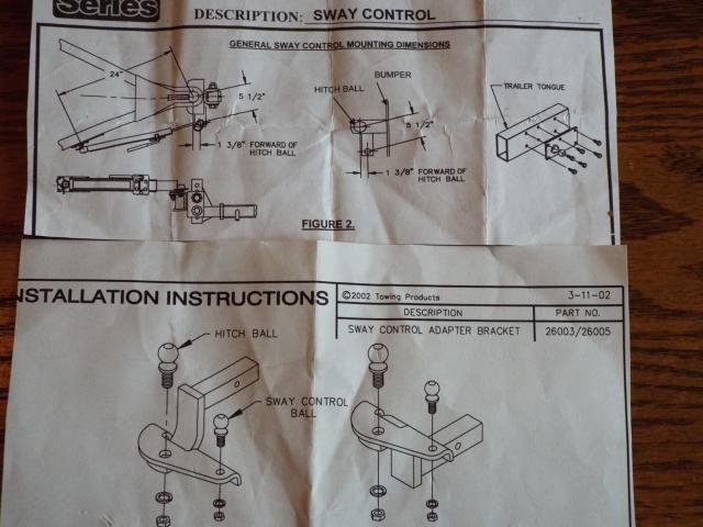

After encountering side winds on a trip last summer, we decided to get a sway bar for our 16' side dinette model. They had them on sale for $49 at the RV store. It came with good directions and drawings to show how to install it. I was able to purchase an adapter bracket that is held in place by the hitch ball, so that I didn't have to do any welding on the truck hitch. It only took about 1/2 hour to drill the six holes and install the second bracket on the trailer tongue. The sway bar tension is adjustable and works very well, especially if you have to travel with a full water tank.
The hitch bracket is a Reese Sway Controller Adapter 2" ball size part #26003 or part #21927. The sway control is a pro series #83660.
