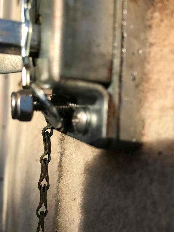

Greetings Scamp folks. I purchased a 1997 16' about 3 weeks ago and have had fun and challenges getting it camp ready. Winding down the long list, our Scamp got a new table top and door gasket today. Since it did not come with a key, I ordered a new outside door handle. As I was replacing the old one it was clear that anyone with a phillips screw driver wouldn't need a key. I've attached photos of a simple mod to keep the handle from being removable from the outside with the door closed and locked. It's not pretty yet it's effective. I drilled the lower handle hole through the inner latch assembly and installed a #8-32 pan head phillips machine screw that's 2 and 1/2" long with a washer and nylock nut. The hole location did not allow the washer and nut to lay flat on the latch housing. There may be other solutions that I'm unaware of being a newbie. A big THANK YOU to Scamp! They have been very helpful, supportive and have a good selection of replacement parts reasonably priced with fast shipping.

1) Photo-1: On mine, I put security screws, maybe you can do the same thing if it's not too late. It's more for keeping an honest/lazy person from getting into your camper.
2) Photo-2 Maybe you could remove the screw then put the Locking Nut up against the locking case (Flat wise). Now see if you can run the screw in and catch the locking nut.
3) Photo-3 I've found a way to make the hinges a bit more secure but not yet burglar proof. I got rid of the screws that held the brackets on the door and replaced them with bolts going in the opposite direction. I then was getting ready to replace the two bolts with security locking bolts (meaning once installed, it couldn't be taken off easily) that actually hold the door on the hinges (itself) but thought I'd wait till I was totally comfortable with all the mods I've done to the door so far.
