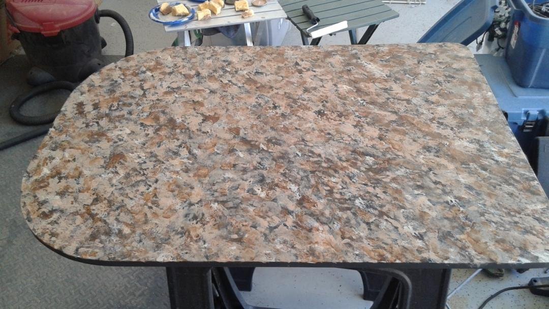

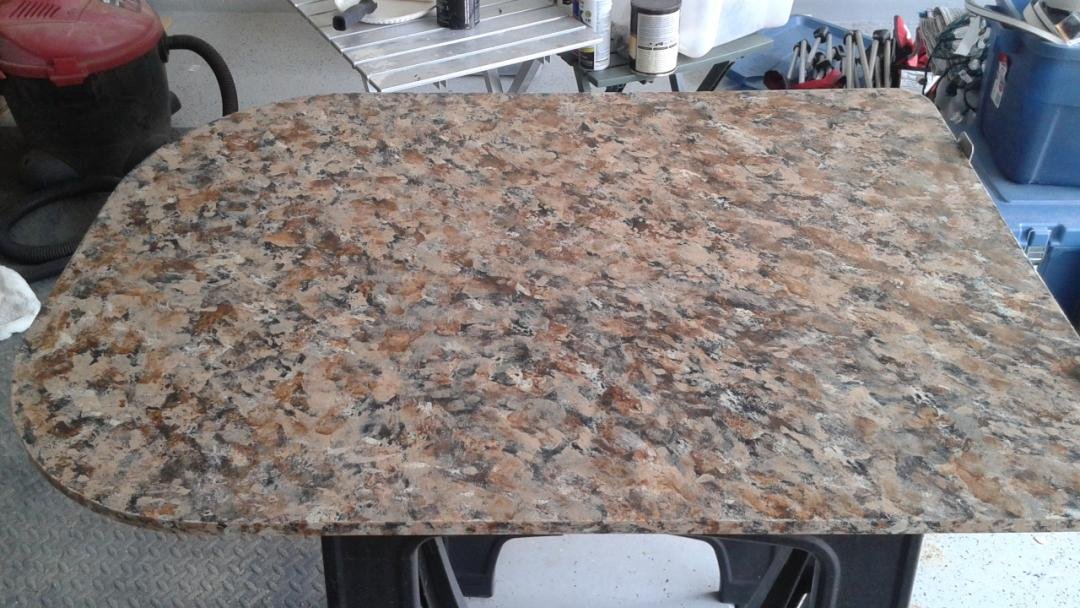

We loved the Giani Granite FG-GI SICILIAN Sicilian Granite Paint Kit For Countertops, Sicilian Sand so much in our Escape 17 countertop project  that we decided to try the Scamp 13 table with the remaining product.

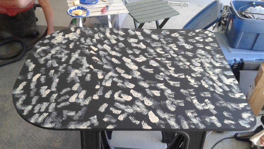

First step after sanding and cleaning the table is to roller on the special primer base which is black. Step two is to start applying the colors with a loofa sponge:

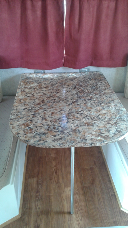

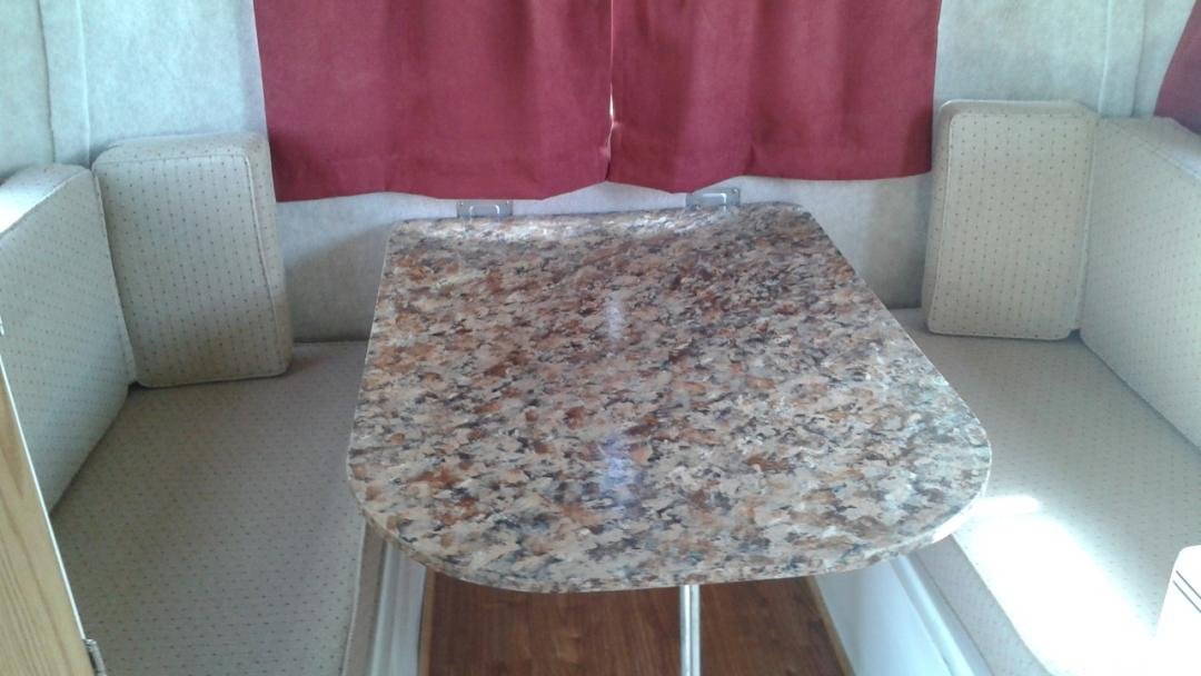

After you get the color layers and pattern you want then 3 coats of Sealer and a couple of days of dry time.

Looks awesome
That table sure did turn out very very nice! It looks like a pro did it :-)
Last seen: 1 week 19 hours ago
Table
Thanks Earlene,
The Pros on this one would be my daughter and the better half..  laugh
They will enjoy your comments.
