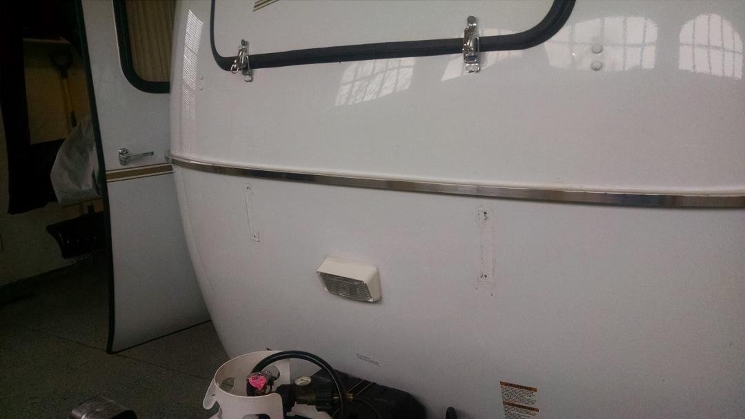

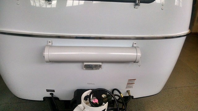

Removed the "stinky slinky tube"
  • I don't like how the hose tube will yellow (and collect dirt) on the front of the camper....so I took it off. I never did any type of fiberglass before..but I have patched drywall ..and have frosted cakes before ...so how much different can it be...drilled off the head of the rivet...removed the tube holder..scraped off the caulk...cleaned with acetone...filled holes with a marine epoxy patch....ground surface so gel coat would adhere....filled....sanded...wet sanded with 2000 grit...

 Nice work. Did you have to do any color matching on ur gel coat? I know you have a new Scamp, but sometimes it can still be off.

It is OEM Scamp Gel Coat
Greg
I got the OEM gel-coat from Scamp. And with the holes being less than 1/4" in diameter....once they were wet sanded and buffed...the whole front just shines.
