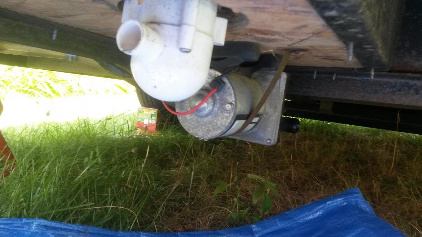

Actually the job turned out to be fairly simple, once I figured out the pump placement and fittings. Here's a picture of the old pump location underneath the shower tub (the hoses have been removed).

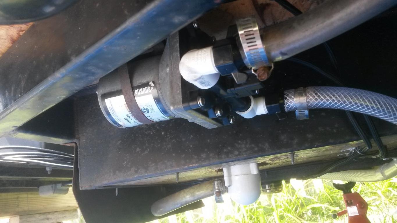

Here's the new location underneath the toilet area.
Here's a bottom view of the new pump mounting (the front of the trailer is towards the right of the picture).
Here's what i needed for this project, most of which I got at Lowe's and at an auto parts store.

The pump is mounted on rubber feet with Phillips head screws. You can use these same screws for the new location, so leave them on the rubber feet when you remove the pump, they will self tap into the floor at the new location. BTW, the floors are 3/4" thick, so make sure to use screws 5/8" or less when you mount new stuff. After removing the pump, take off the hose adapters from the pump inlet and outlet and screw on the elbow connectors, then screw on the hose adapters to the elbows. After mounting the pump, run the new hose from the filter to the pump inlet, then cut the existing hose going to the waste water tank to the right length. The only thing left is to lengthen the existing wiring using butt connectors, heat shrink tubing, and cable clamps. If you're not familiar with wiring, there's plenty of videos that can help.
