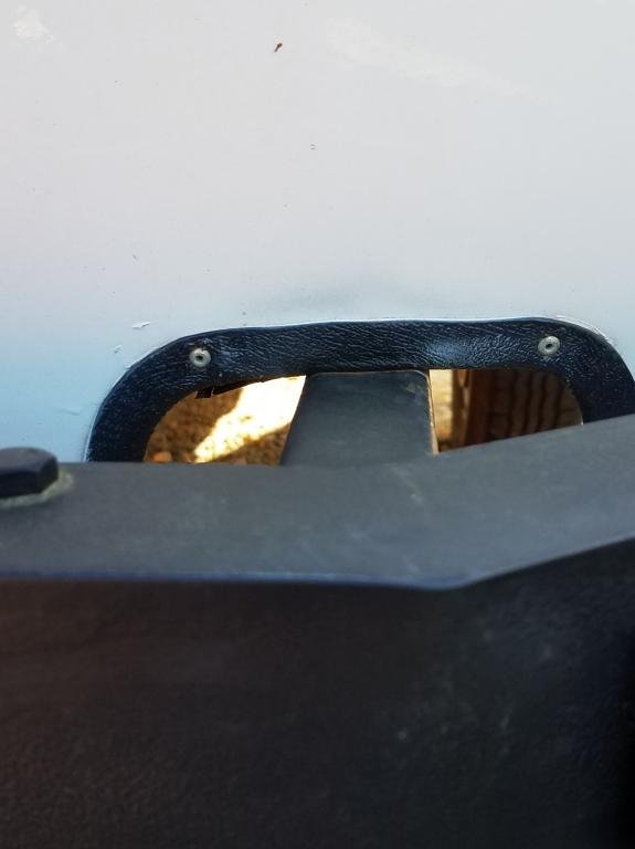

Hello there.  My wife and I have been Scamp owners for about five years and have upsized from sa 13 standard w/o bathroom to a 19 deluxe layout 2.  In that transition we went from a trailer we bought new to one that has had a number of previous owners and has probably seen better days.  We got a good deal on it and I am a handy type person with more than my fair share of patience (ask my wife.)  I bought our new trailer knowing that it would need some floor work but, I don't have the experience to know just how much I need to replace.  There is rot in the OSB along the rear of the shell, primarily where the frame fails extend to the bumper.  On one side the rot is bad enough to faintly see light, and on the other it's nearly as bad.  99% of the osb is in good shape.  However, since the wood is tabbed to the trailer and is a supporting structural element, I assume that this is a particularly bad spot to have the damage.  On looks alone, the shell has settled onto the frame, not the 1/16" gap I believe it should be, and is when I look at the front by the landing gear.  I'd say the damage extends back 4-5 inches from the shell.  I'll try and attach some images, but I'm new so you may have to bear with me.  I've done some digging and read a few of the threads more than a couple times and have come up with an order of operations that I'd like some feedback on if y'all have the time.

Looking at the pix I have attached and assuming the rest of the current osb is in good shape, should I replace the entire dinette floor or just the back foot or so?

Oversize holes and fill for the screws is overkill on a Scamp floor. This is usually used for cored fiberglass (Boat decks or Casita floors.) Never seen any problem on Scamp floors. I use wood to metal self tapping countersunk screws. You will need to drill a small pilot hole for the self tapping screw.
The trailer is made with polyester resin so polyester will work OK. I sometimes use West Epoxy resin, you have more control over set times with the different hardners. Once you use epoxy you have to stay with epoxy.
I use exterior rated plywood 5/8" I think is 4 green bars for ID markings. Some S-19 I have seen 3/4" wood used on the upper floors. Measure what you have at a good location and go with what you have.
I have replaced the last 8-12" all the way across the back in a couple of trailers. I join the floor with a 3/4" dado joint (lap joint). Near the walls you have to work the old floor wood joint by hand. I use Gorilla Glue since it foams and fills any gaps. I also use counter sunkwood screws on the dado joint.
When making you template I rough cut a piece of lauan and hot glue 1" wide pieces of cardboard to the lauan edges to get the contour. Easier to deal with than all cardboard template.
FWIW: It takes me about the same time and effort for me to patch or replace the whole dance floor.
