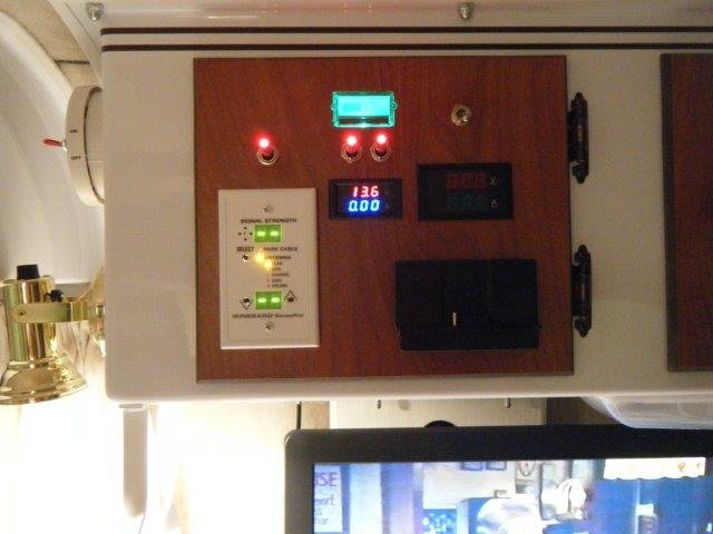

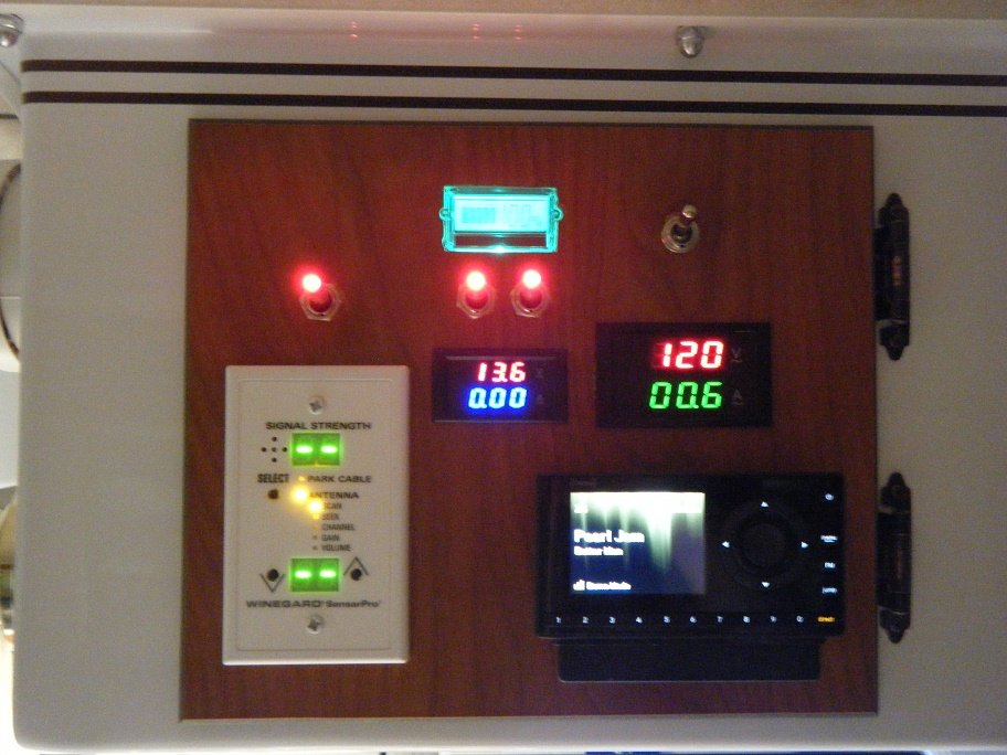

Here’s a great way to monitor your electrical power onboard your camper. Most of the items here are gotten via eBay and Amazon at a very reasonable price. What’s nice about mounting in the door is that it makes for easy access to your gauges etc (from the back) incase there is a problem later.
I installed switches for most everything to give the option of saving power incase battery power becomes a high priority.
Update: the AC and DC gauges cover Voltage and Amperage and the gauge on top indicates battery capacity. I noticed it's hard to see the battery capacity meter, so I put a pic of it (you can see it better) under this sentence.

I take it the switches shut each of the guages off for sleeping time and/or boondocking drain?

Thanks and yes, ALL gauges and devices can be shutdown by the individual switches on the panel. The other day I installed a master switch to cut off the battery. This option stops putting wear and tear on the breaker switch and pulling DC fuses. I installed it under the sink and very accessible.

Here's links to where I got my gauges: DC Digital Volt Ampere Meter, DC 12v lead acid battery indicator, AC Digital Volt Ampere Meter and LED Rocker Toggle Switch SPST ON/OFF...
I'm now thinking about installing a Digital Frequency Panel Digital Meter Gauge
As to the quality of these items, only time will tell.... Hopefully this helps...

thanks... its really nothing more than reading a map...  I've also added a Hz gauge and 12v test points..
