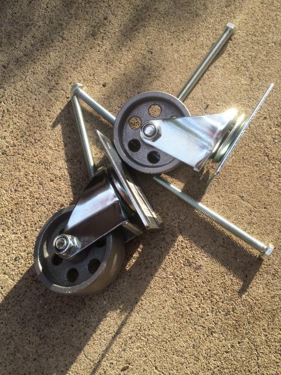

Hi, we are just got our 1979 13' scamp (yay!) the issue is we couldn't get it into the driveway, it wanted to bottom out (our drive way is pretty normal, not steep at all) ) The first picture I am posting is how it looks in drive (does it seem low?) the second is of my husbands "solution" to the problem.... Ideas? comments, suggestions? please ;-)  ps.I will post other new pics of the "project" soon :-)
Last seen: 4 days 17 hours ago
Axle looks done
Given that it's a 79 probably never had an Axle replacement. It looks to be riding quite a bit low which is an indicator it's time for an Axle.
