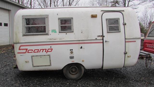

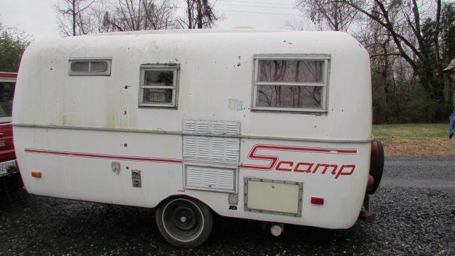

My Scamp does have a title, the VIN is E910063. Over the years Virginia has made it increasingly difficult to get a title if you don't have one in hand, so I was glad this one had it. Aside from having some extra screw holes in it, the shell seems to be in good shape. I'm attaching a few before pics, maybe someone can tell me if all of the add-ons on the shell are factory. The access doors on the lower rear look like they might have been added at some point and the 4 tail lights look kinda odd.... why 4 of them??

Add ons
The access doors are add ons but they really come in handy. The four tail lights were add ons at that time but are now requested options. The higher tail lights are a real good thing for safety and visibility. The old top hat tail lights are dim and hard to see, I usually replace the orig. top hats with  7" LED school bus lights. The majority of scamp accidents are due to rear end collisions. FWIW the majority of Casita wrecks are from trailer roll overs.
Get some Jo Max house cleaner and clorox and scrub it down then let it set in the sun for a day and the shell will brighten right up. Expect to spend about  $1.5-2K to fix it up but you should have a really nice trailer when you are done.
The awning track is also an orig. option which is nice. You can use a bad awning and water won't run down the side of the trailer.

In it's day
In it's day it was a very nicely equipped trailer. Did the PO know where the cabinets went to? I have a 16DX that you can get measurements from if you want to go with a wood interior. My trailer will be back in Va. in April.
Last seen: 10 hours 53 min ago
Blank slate
Great project trailer. Need some inside pics so we can see what's what. Door looks to be having alignment issues which is not unusual in older scamps, but if all the interior support structure is gone, it could be roof sag related.
This one should clean up nice, love the old jalousy Windows. Pull them, clean them up and reseat with butyl tape and they'll be good to go for a long time. Hatches and extra lights are great to have like Eddie says.
