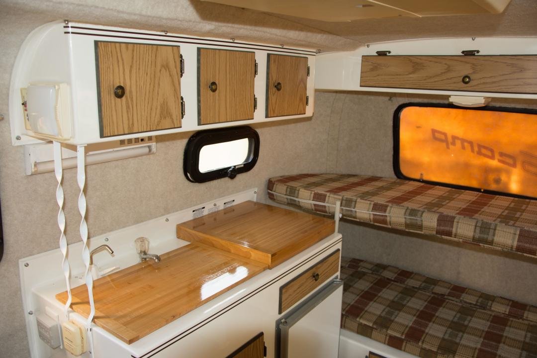

Making counter space by covering sink and stove.  Made tops by using 3/4 inch strips of maple, glued together and then planned to make smooth top.  Finished with a gym floor sealer.

Looks great.  I am however
Looks great.  I am however more curious about the florescent light  above.  Your add on?   Good lighting when I'm around prepping food is extremely important.  Did you wire in or is it a plug in?  I use a plugin here at home.    Barb

No extra lighting,what looks like lighting on the counter is reflection from small window
