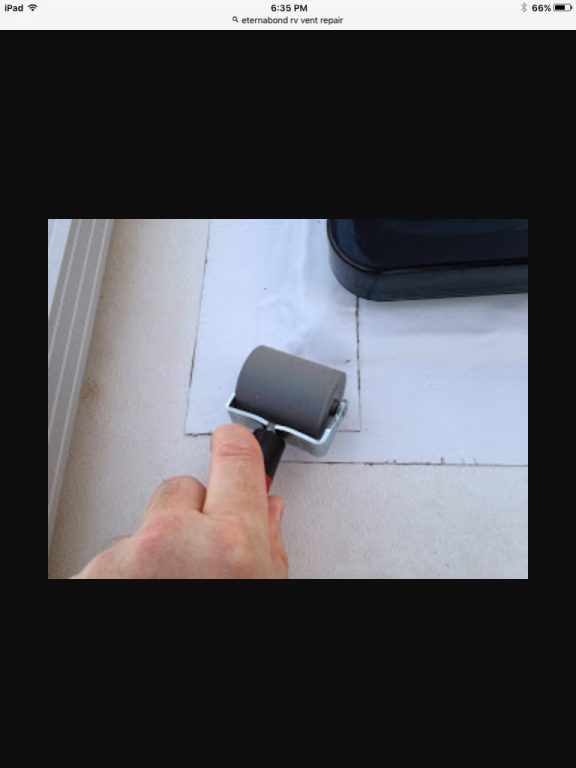

Just purchased my first scamp which has become a project. The escape hatch is leaking and the previous owner had so much caulk along the edges of the hatch it looked more like a wedding cake than an escape hatch. I've stripped the caulk off with plans of popping the rivets and resealing with butyl tape. Today I came across a product called enternabond which is a tape that goes on the outside edge which would not require rivet replacement. Does anyone have experience with this product. Really would prefer not to pop rivets for fear of damaging the escape hatch. Any thoughts would be appreciated.

Ah Eternabond
You found an excellent product in the Eternabond. I used it when we went to the Dark Side with our sticky trailer. Every 12-18 mos on a rolled roof trailer you have to go up with the Dicor and reseal or you'll get the dreaded delamination. I found Eternabond and did all my roof seams with the product eliminating the need to caulk annually. We never had a leak after doing that and the lifetime of the product is around 18 years.
Now the downside. It is almost impossible to remove once applied. If you ever needed to replace your vent the best method is to take a razor cutter and cut the eternabond around the vent edge and remove the vent leaving the Eternabond on the trailer. Replace the vent and apply new Eternabond right over the vent flange and existing Eternabond.
I think you have a good use of a good product on your Scamp vent and you can always order replacement lids if they crack. The Eternabond will probably still be there and intact long after you're done with the trailer.

Last seen: 21 hours 50 min ago
ETernabond Tape
