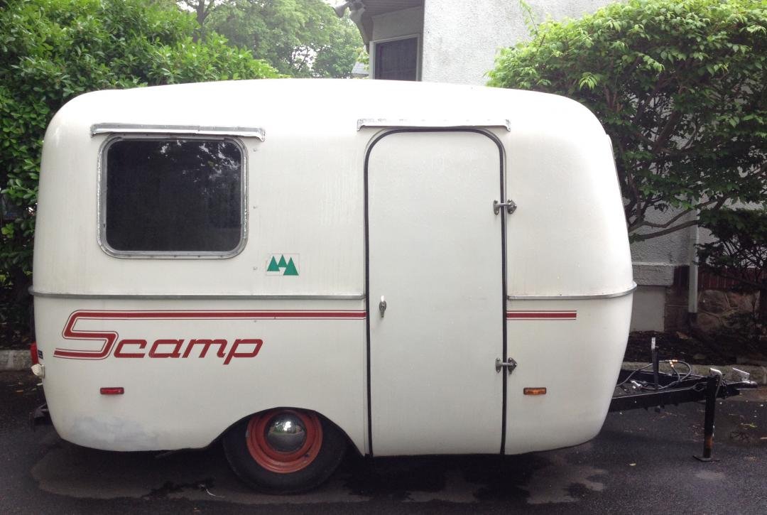

Hello All!  I am a new member looking for help in fixing up a 1977 13 Scamp.  It was bought with the plan of remodeling a few years back.  Unfortunately, that never happened and it turned into my kids' clubhouse.  I do not have the physical ability or time to do the work myself now.  Any advice on how to find local resources to complete a variety of repairs?  Perhaps an rv shop?  Talented handymen?  Not sure where to start.
Here's what I know about the camper:  The shell is solid with no cracks but needs cleaning/painting.  The front and rear windows don't close, roof vent leaks, and all should be replaced.  There is some mold from water leaking in the front window.  Not sure about the water tank, stove, fridge, or heater.  Electric inside and brake lights used to work.  The interior cabinets, table, bunks are all original but could use sprucing up. The sub-floor was removed and replaced before I purchased it.  I mainly want to be sure that it is safe to tow and operate as I've never had it on the road.
Any advice would be appreciated!

Put some new tires on it hook it up and take it out someplace close. Go camping its still a lot better then a tent. See what works or like the other posting said sell it. Don't know how old the photo is but i think you could get half the price of a new Scamp for it (13' standard) then all you need is the other half with no troubles just fun. Your in a good place don't over think it. :)

If you aren't the type to do light mechanical work, then I'd second the recommendation to sell and get a newer one that is in "ready to camp" state. I'd buy first, because it can be difficult to get one sometimes.
Anyway, if you want to work on it and/or get someone to do some work for you here is at a glance what I can see from the one pic. We'll need inside pics to be able to tell you more.
  1. No battery or battery box on tongue. Marine 12v group 27 at Walmart approx $80 Battery box on Amazon $19. You should be able to add this stuff yourself, if not, just a local RV or automotive service center should be able to add for low cost.
  2. No propane tank on tongue. It does look like you have a hold down but not the lock piece, can't tell. Looks like a regulator and hose may be present there as well. New to you filled tank at Home Depot approx $50 + anything that's missing to mount it and hook up regulator.
  3. Shell looks to be pretty good from the pic, if you want to polish and wax check the Maintenance forum table of contents under cleaning and waxing.
  4. My guess is that's the original axle and just at a glance it appears for the long term it will need an axle replacement. Approx $300-700. It will go for now to get camping, but long term it would need to be dealt with.
  5. If the tires are more than 5 years old then replace before towing. Approx $160 for two and $240 including spare. Love the baby moons.
  6. Tow vehicle type?? Hook up and test all running lights, brakes, turn signals. If those aren't working they must be dealt with prior to towing. Uhaul can take care of that for you inexpensively.
  7. Window is an aftermarket replacement. I don't know if it leaks, but is pretty simple to pull it, clean all the old butyl tape off of everything and put new butyl and reseat. Cost: Labor + $12 for butyl tape roll which will do the windows on both sides. If it is not leaking don't worry about it for now.
All that I can see from here. Can tell you more with more pics and descriptions.

The first thing you need to address is the running gear: Tires, Brakes, Lights, Wheel Bearings and the structural integrity of the frame. First thing is get the frame inspected for any cracks or weak points that may fail. You also want to inspect the hitch and it's operation and adjustment (if it is adjustable).
Assuming that the frame is indeed structurally sound you probably need to replace your axle and tires. We can tell from the picture (your Scamp is sitting very low to the ground) that your axle is probably worn out. Your tires are also probably more than 5 years old and will need to be replaced, you can buy new tires, pre-mounted on new wheels (5 hole wheels), quite reasonably over the internet.
When you replace your axle I would strongly suggest you replace the axle with an axle that has the electric brakes pre-installed (also upgrade to the 5-stud wheel mount). This way you are upgrading the Scamp at the same time you are fixing it, you are also improving Safety for you and your Family.
The next item would be the operational lighting system for the trailer (Brake Lights, Tail Lights, and Marker Lights). This includes the new 7-pin plug that will be required for the new brakes.
Now you have a Scamp that can be towed Safely !!!!!
