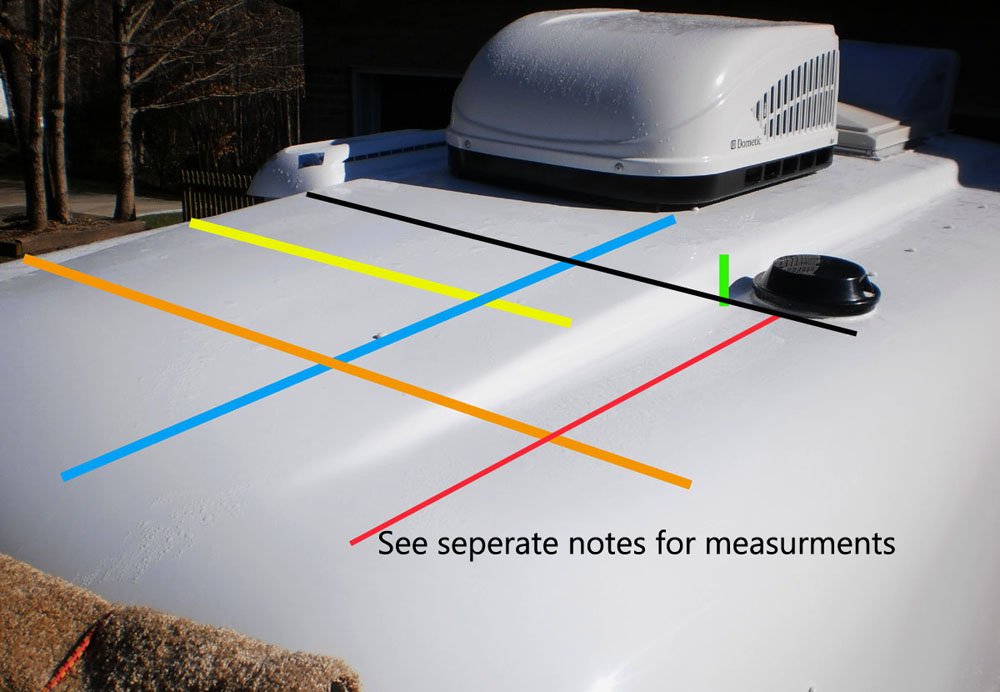

How is the roof in my 2015 Scamp 16 (#4) constructed in regards to support for the air conditioner?  Is there wood reinforcement that I could utilize to anchor screws to hold a solar panel bracket in place? Would a stud finder reveal the location of the reinforcement?
Note that brackets could extend on the roof along the sides on the AC unit if needed.
Below is a photo of my trailer's roof with added colored lines which I am using for reference to measurements.  Feel free to refer to the photo to describe the internal construction.

Roof Support
This is a picture of a S-13 DX A/C support. The tabbing is for the front bath wall. Usually the support is about as long as the A/C unit. On some trailers you can see the see or feel the support under the rat fur. The support is only on the underside of the trolly top. The roof thickness can vary in the non-supported area of the roof, I would say on average the roof is about 1/8"- 3/16" thick.
