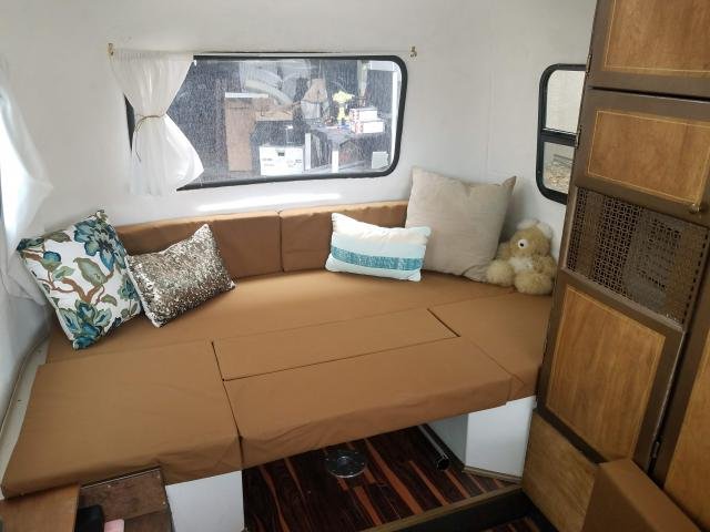

Made one with some plywood,
Made one with some plywood, brass angle trim and some resin. It was nice but heavy.
Just replaced it with a half table - just plywood sanded and painted nicely :)

Half table, nice mod!
Very nice, Skych! Love the half table with seating for six: cocktail time! How do you convert that setup for bedtime?

Thank you! The table just
Thank you! The table just pops off the post and top just drops like usual for maximum bed :)
