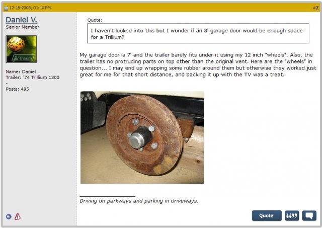

I saw this online...
I saw this online... He's using Rotors as wheels... It looks like....
